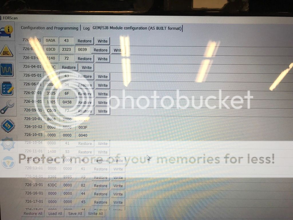

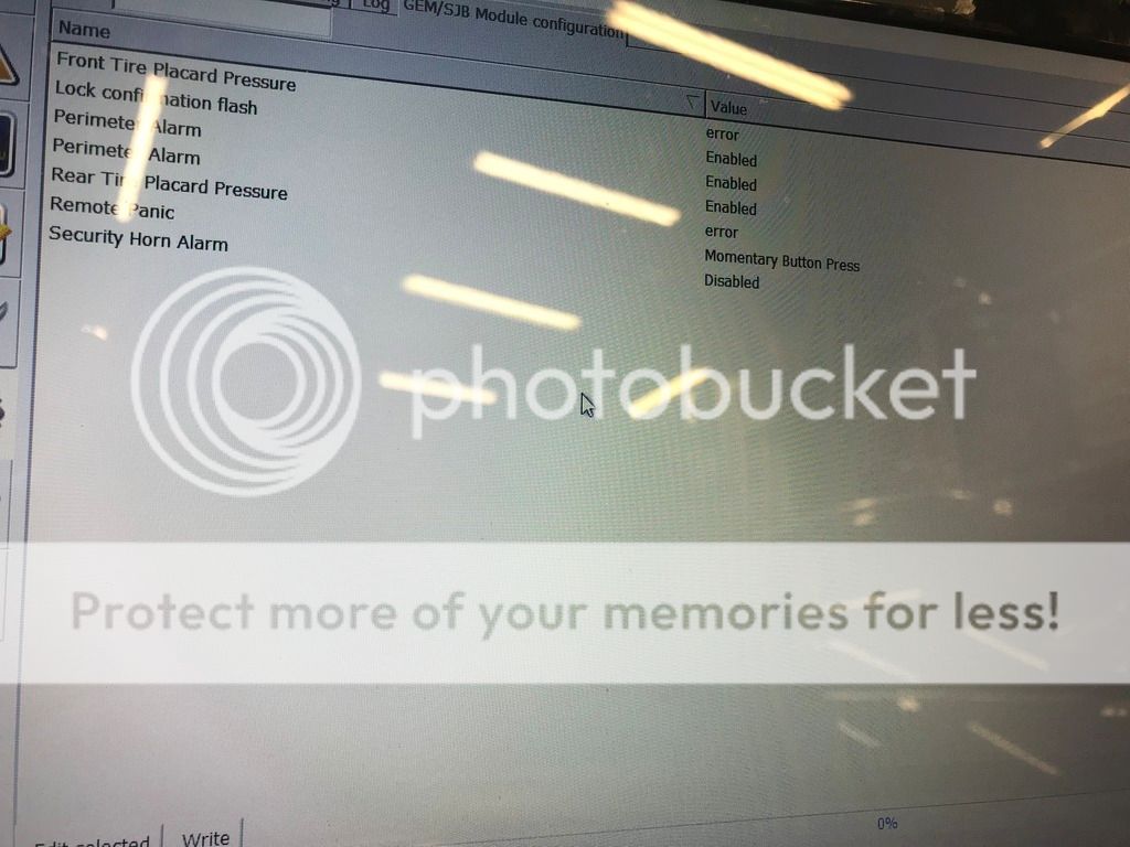

I also tried resetting the module on the recent version but it got hung up. I just ended up retraining (yet again) the TPMS sensors to clear it. Attaching the data points I do see in the GEM. I was able to get the ABD of my car online and have that saved. Happy to share anything I can if it's of help.

Wanted to put in an update. In the GEM/SJB I changed from:
726-02-01 03C0 2323 0039
to
726-02-01 03C0 0000 0039
Before changing the original configuration showed front and rear tire placard at 35 each which is correct. I made the change and it now says error on the configuration but driving it around so far hasn't resulted in anything. Will update as a I find out more. I did note the TPMS light does turn on the initial start up check of key start so I'm not confident I have it nailed. Was thinking I may need to change something else.

I disable the tpms by changing
726-02-01.
0000 0000 xxxx disabled
03C0 2323 xxxx enabled

On my ‘13 Boss 302 this worked perfectly.......
Lx90coupe wrote:
Sat Oct 13, 2018 5:41 pm
726-02-01.
I swapped sensors and reprogrammed multiple times......this incuded a set of Ford sensors. No luck. Now that I shut the system off I just check tire pressures like I did for many years. No biggie.

Ok great, thanks for the positive feedback, good to hear that there is a Solution for the Problem!
