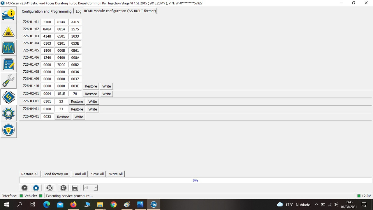

Hello,
I just replaced a battery on a ford focus 1.5tdci with one VARTA E39 AGM 70Ah 760CCA
https://i.postimg.cc/P5ZDLdFN/bat-type.jpg
I have this options on FORSCAN but looking at the previous post I have some doubts if its the correct choose
Is there any other place to change battery type?

Your are probably right. According to this original sheet posted a few years ago, you should set it to 01. In addition to using the AGM setting the vehicle looks for the CCA rating.
https://drive.google.com/file/d/1EJnizs ... o6nS3/view
After installing battery you should do a battery reset to start the monitoring fresh.

Hello
thank you for your reply
Done everything you said, the stop/start works perfectly, so it must be correct the calibration
regarding the codes, i went checking other parts and found this:
So its correct? 01?

Looks like according to this older posting from a few years ago and if everything workd.

It must be a forscan bug, because I only replaced battery type on central configuration! Then I see your post and went checking were to find 726-04-01-xx
And see that was already modified to 01 like you said!
So there is no need to any more modifications?

LENKO, many thanks
well, i done battery type change and bms reset to be sure. Stop start functions perfectly
Will have a look of the battery age to check if its correct
