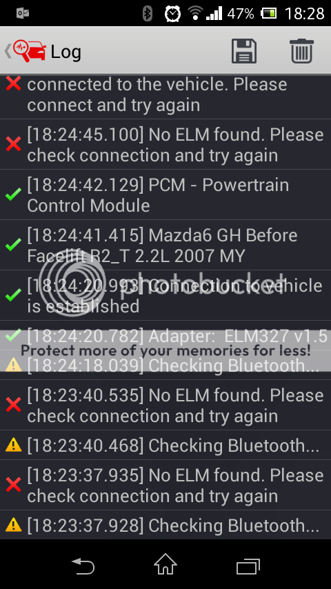

I'm using this v1.5 adapter:
It's paired and i have a connection to the OBD Adapter. The warning is not "No ELm found", it's "please turn on th ignition"
With Torque it's the same Problem.
The WiFi Adapter is working...

I have the same problem with this bluetooth adapter.Torque is perfect but Forscan and Windows versión isn´t posible conecction.
With android versión try and is ok connection but only the start it.
Sorry for my English :D
