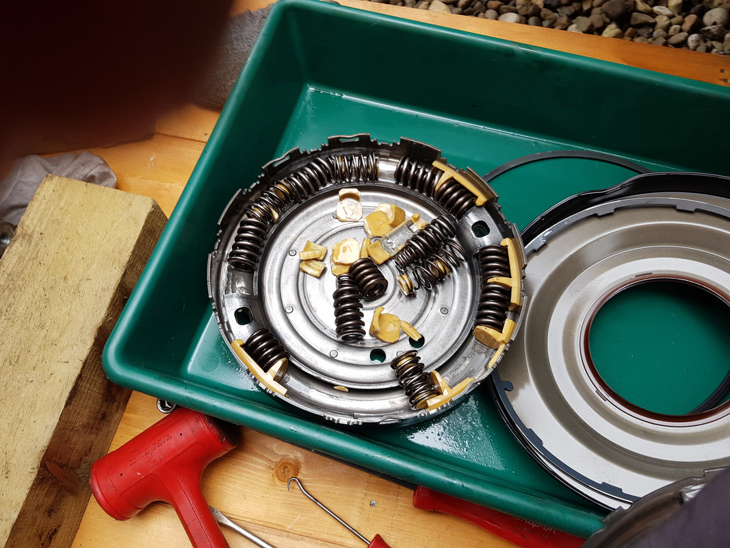

I have been stripping down two of these getrag DCT 450 auto gearboxes to make up one good one to fit back into my 2013 galaxy. Serial numbers AV9R7000 AG and AH types
The failure of these gearboxes I have found comes from the poor choice of plastic type parts that make up the twin clutch and hold the thrust springs in place (£100.00 a set) and also I found one spring broken (£100.00 a set) as well in one of the two clutches I took a part. The other gearbox had one of the plastic twin magnetic selector magnet broken off its bonded fork selector? It would appear that these are just clip on items held in place with a recressed indent in each of the four sides and push fit on to the resin bond on to the metal fork selector. These need to be check for cracks on any strip down.
The failure of these components leads to contamination of the oil and blocking of the mechatronic valve controller and failure of drive unit even with two forms of oil filter.
The only answer is a check of the oil (service change at 30K intervals) and if any form of plastic bits observed in the oil then its a complete strip down of the gearbox as the design only enables the internal oil filter (£20.00) to be removed once the case of the gearbox has been removed along with the clutch.
If you have a good knowledge of engineering and tools (two leg bearing puller needed) you can strip these gearboxes down, clean them (every bit needs to be striped and cleaned) and obtain replacement parts (Ebay) and put them back together (youtube) are good places to look but look at more than just one item to get the info on how they come a part. Or buy an exchange gearbox to refit.
